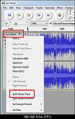

  4. Originally Posted by yetanotherlogin View Post
    I used Audacity followed by Effect > Invert, but it didn't do anything.
    First split the stereo track into separate left/right channels.
    Highlight only one of the channels. Apply Effect -> Invert. Make them back into a stereo track (the option is just above "Split Stereo Track" in the above menu). Export the file to whatever format you want.

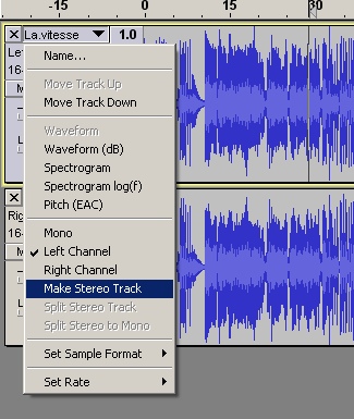

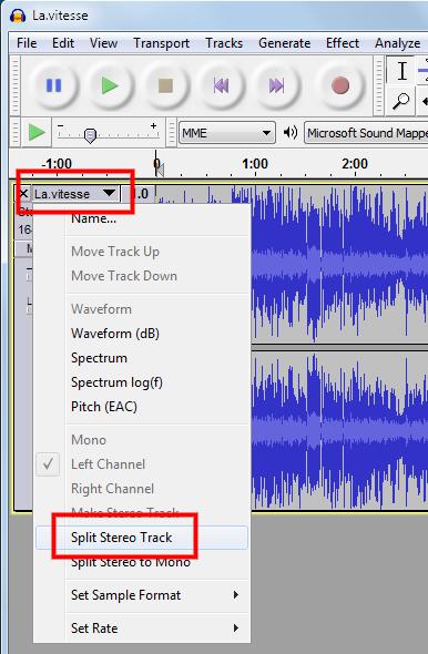

    Thanks but no go. I must be misunderstanding a step, maybe selecting the track:
    1. Open AAC file in Audacity
    2. (my file.AAC) > open combo per screenshot above > Split Stereo Track
    3. With upper track (left?) preselected, ie. with yellow border, Effect > Invert
    4. (my file.AAC) > open combo per screenshot above > Make Stereo Track
    5. Play: No change.
    I attached a screenshot.
    Image Attached Images
  6. You need to mark the whole track, not just select it. Click on a bare spot on the little panel at the left, say, on the text that says Right or Left. The background of the entire track will turn dark. Then Effect -> Invert.
